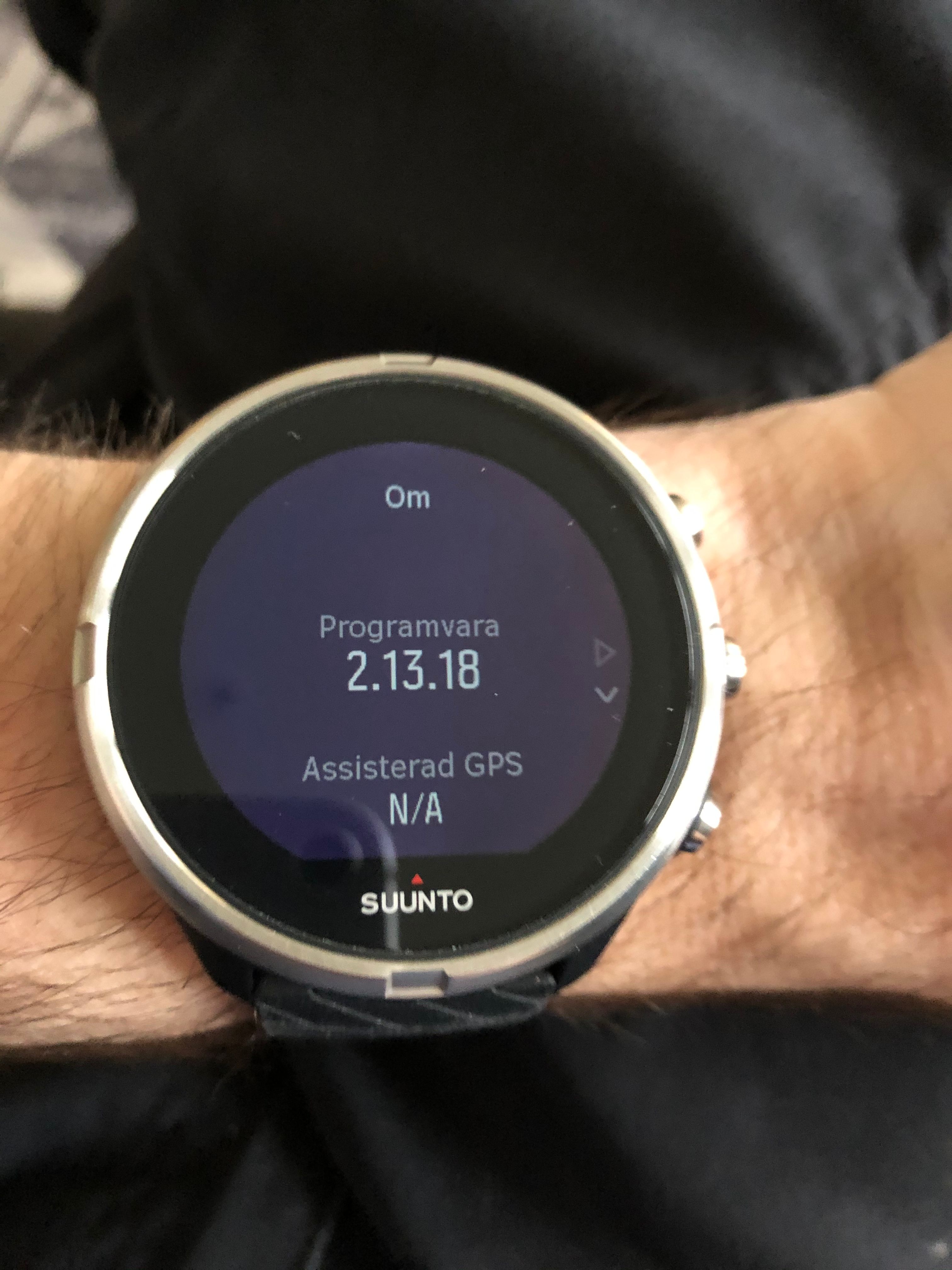

              @MaxiPalle I have noticed that my AGPS file hasn’t been updated since december 18th. Soft reset and reinstallation of the app hasn’t resolved the issue. The app tries to optimize GPS every sync but it never shows up on the watch. Now it says that AGPS is n/a on the watch. Can anyone help?

                        • R Offline
                          Richard Thygesen @Łukasz Szmigiel
                          @Łukasz-Szmigiel This is how it looks on the watch.

                            @Richard-Thygesen I’ve just called Suunto support and gone through a factory reset with them. Seems to ok again now fingers crossed

                              @Phil-Powell Perhaps a hard reset is all that is left to do for me also.

                                    @Dimitrios-Kanellopoulos now I have the newest A-GPS file. Not sure if it is related but after changing the setting to GPS only an syncing I got the file.

                                      @Richard-Thygesen This happened to me as well a couple of days ago. Did the same as Richard Thygesen. Changed to gps only and Agps updated almost directly.
