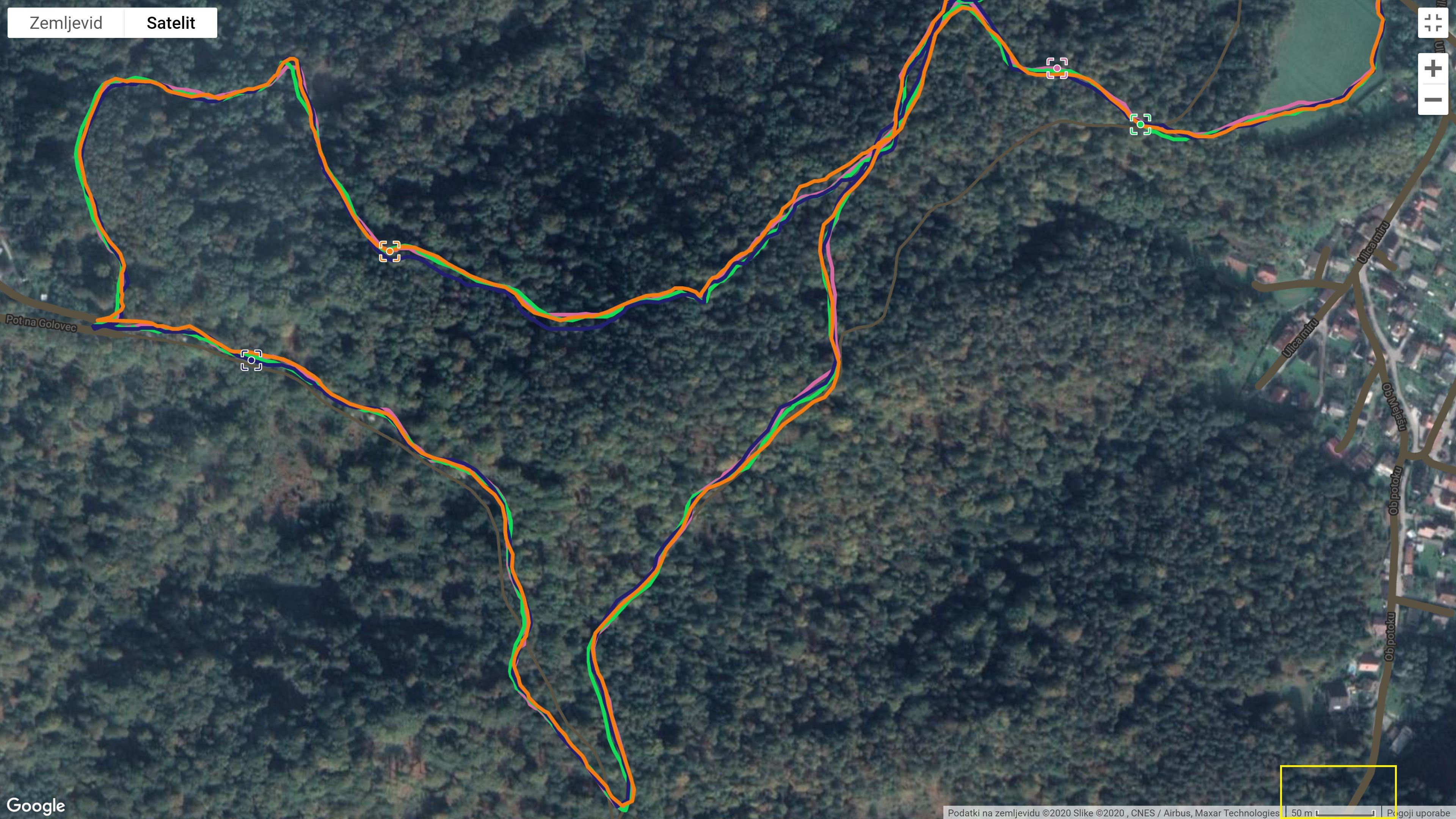

                          Honestly, i’m quite pleased with the accuracy lately. These are the last 4 training sessions in the forest and the maximum deviations between tracsk is 15 meters. I use a combination of Gps Galileo,. Only gps give worse results. Gps + Glonas results are really bad - unacceptable to me

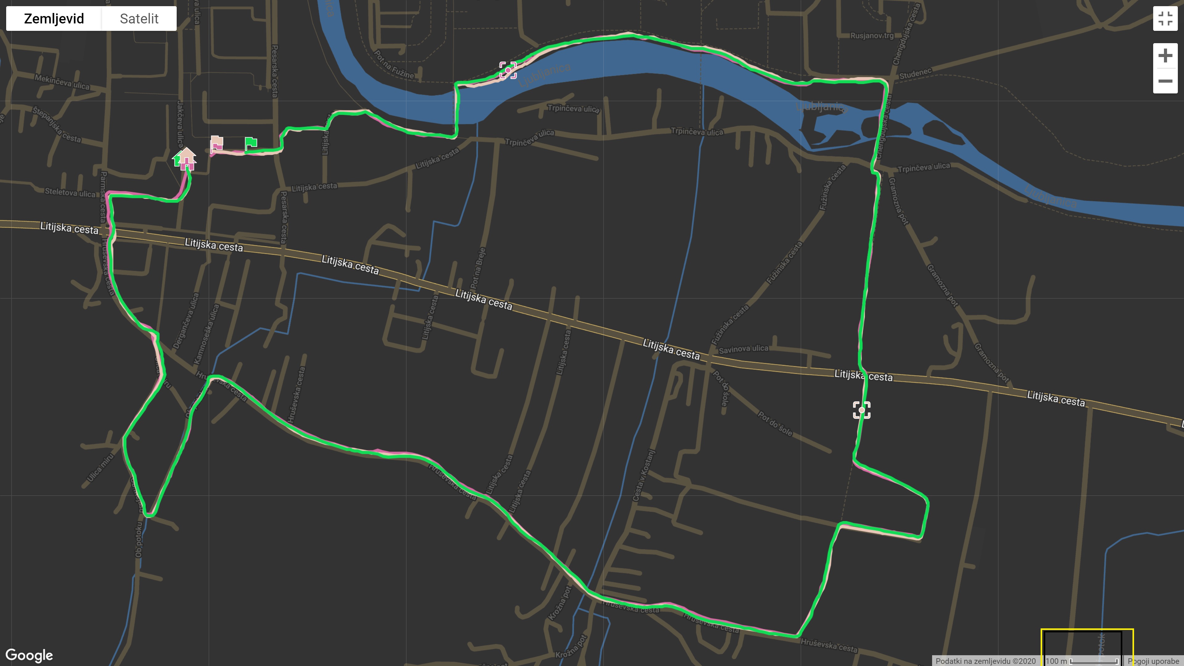

                            And last 3 street runs, clear sky. Almost no deviations. I hope, that stays in new FW 🙂
