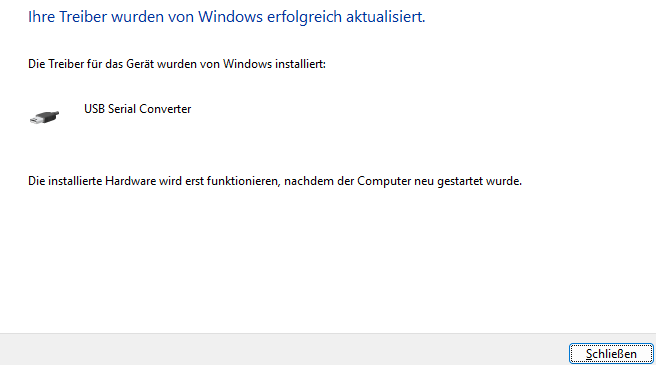

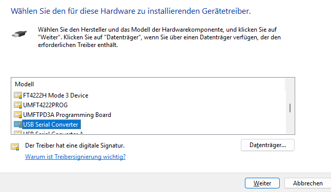

            Garageman @yetanotherdeveloper
            @yetanotherdeveloper Now, it worked well! Thanks a lot!

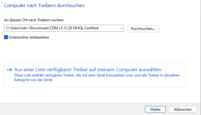

            The mistake I made (due to German Windows 11 installation) is that I did not understand where to explicit select the inf file and “connect” it to the “USB Serial Converter”.

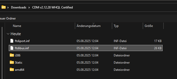

            When selecting “Update Driver” do not select “Durchsuchen…”, but the link below “Aus einer Liste verfügbarer Treiber…” - sorry for writing the German “commands”, but I do not exactly know the English translation on Windows -> see my screen shots!

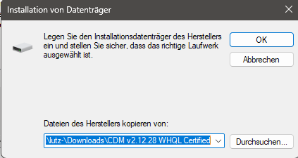

            Select “Datenträger”:
            Selectg “Durchsuchen …”
            Select the ftdibus.inf file:
            Click OK

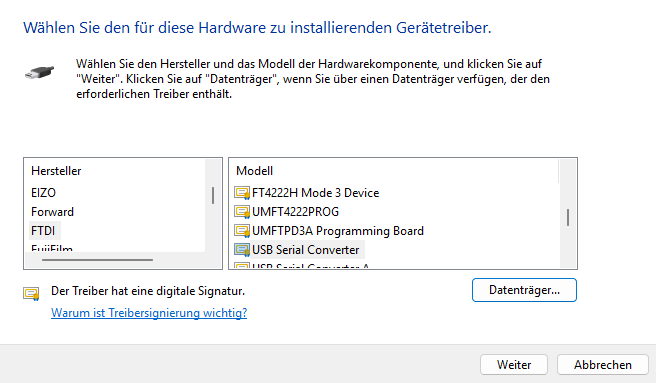

            and select the “USB Serial Converter”:

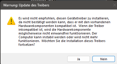

            A Update warning will be displayed: Ignor it (press “Yes”)
            Done!

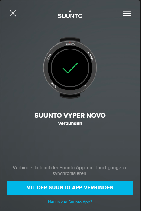

            Finaly, SuuntoLink connects to my Vyper!!
